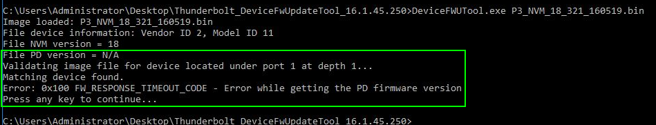

Now we use TPS6598x configuration tool v2.5 to build the TI NVM.
And found the TI version is 0xE0032103 on INTEL Tenlira.
On this situation we can’t use FWupdate to update our NVM (TI+AR).
On command mode: When TI NVM version is 3.21.03, the FWupdate tool can’t identify PD Version. (shown N/A)
That mean TI+AR NVM can’t update by FWupdate tool.
Could you please help to check why TPS6598x configuration tool V2.5 have this problem.

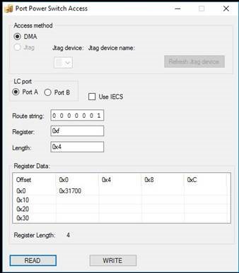

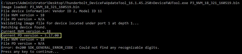

If we used TPS6598x configuration tool V2.0 to build the TI NVM
We found the TI version is 0x31700 on INTEL Tenlira.
On command mode: When TI NVM version is 3.17.00, the FWupdate tool can identify PD Version.
PD version (3.17.00) and AR NVM version (18), that mean TI+AR NVM can update by FWupdate tool.
