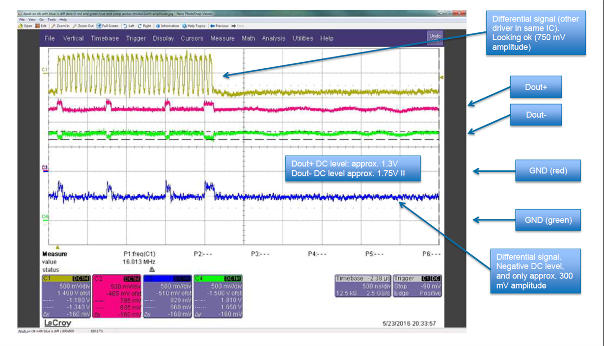

We have a problem with the DS90C031 ad seen in the picture below
The red and the green lines are the outputs of one of the LVDS transmitters and it can be seen that the output swing is only around 100 mV and not the expected 350 mV. In addition the two signals are offset, and not placed on top of each other as expected (forming an “eye-diagram”). The three others transmitters in the part are working fine.
What we are trying to figure out is what could have caused this
an ESD error?
incorrect grounding of units?
accidental output overload?
We worry that whatever have caused this have also caused other errors or possibly an error in the redundant unit that is not yet visible.
  • Hi Mikkel,
    The waveforms looked strange. DOUT+ and DOUT- appeared to have different common mode voltages.
    To debug this problem, you can set the input TTL level of this transmitter to logic 0 (tie to GND), and logic 1 (pull to VCC), and check the levels at DOUT+ and DOUT-.
    Did this happend on one device?
    It will be good if you can send the circuit diagram.
    TK Chin
