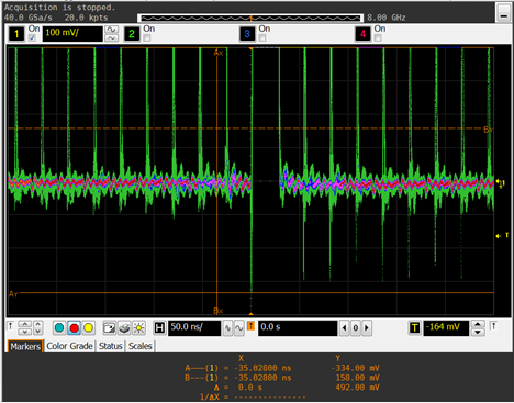

I measured RGB output pin by differential probe like following situation.
And -0.33V is measured at LOW side at R2(39pin).
You set absolute max at -0.3V, but -0.33V is measured actually.
Is this OK for this device?
*following is result of wave.
I am also concerning about my measuring way...
  • Dear all,
    Could you answer this post?
    I think that -0.33V will damage to device because of -0.3V absolute max.
    Additionally, I would like to check two things.
    ■CHECK 1
    Are RGB output pin applied to Absolute Maximum Ratings at all?
    ■CHECK 2
    Are there possibility that R2 output pin will output the voltage up to -0.3V because of internal circuit?
