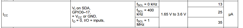

Customer would like to know the current consumption when our chip is in active state with VDD=3.3V.  Furthermore, they would like to know the consumption when specific GPIOS are configured an inputs, and some specific GPIOs are configured as output with specific output at Hi or Lo level.
May I know what kind of current consumption value we can deliver here?

    Customer's target to have it below 5mA.  Do you see any possibility to achieve this or any other chip with the same funcionality can make it?

  • Hi Antony,
    Sorry, but I was misunderstanding the question that was being asked.
    Please take a look at the following image which shows the MAX current consumption of the device which is under the 5mA that the customer is asking for.
