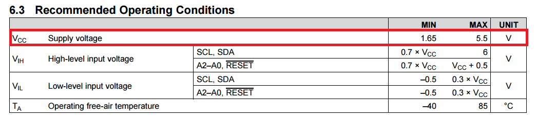

Hi Team,
Please allow me to confirm if there is no problem using in the following condition. I believe it is OK.
Kawai
Hi Takushi-san,
Something to keep in mind with the Supply voltages of the I2C switches is that you will want to make sure that your VCC matches the LOWEST voltage of your VDPUx (whichever that may be). This will prevent unnecessary power loss through leakage current.
