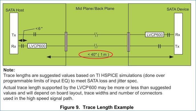

  3. The spec showed Trace length could be <40inch with FR4, would you provide me what’s the trace insertion loss(dB per inch)?

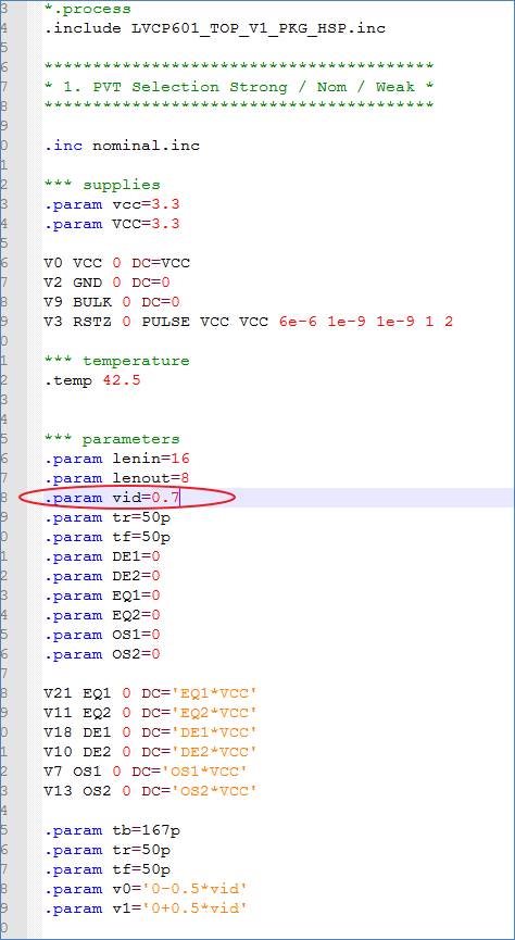

  4. Attached Hspice model that you provided. I looked vid=0.7. Is that mean this TI redriver can only output voltage swing is 0.7V?

    3) This value depends on material, frequency and trace width. You have to ask your manufacturer for this parameter.
    4)Vid is the DC level for input data pattern(VIN1), you can see this in .hsp file. If you want output swing check DiffVppTx maximum value is 900mVpp
