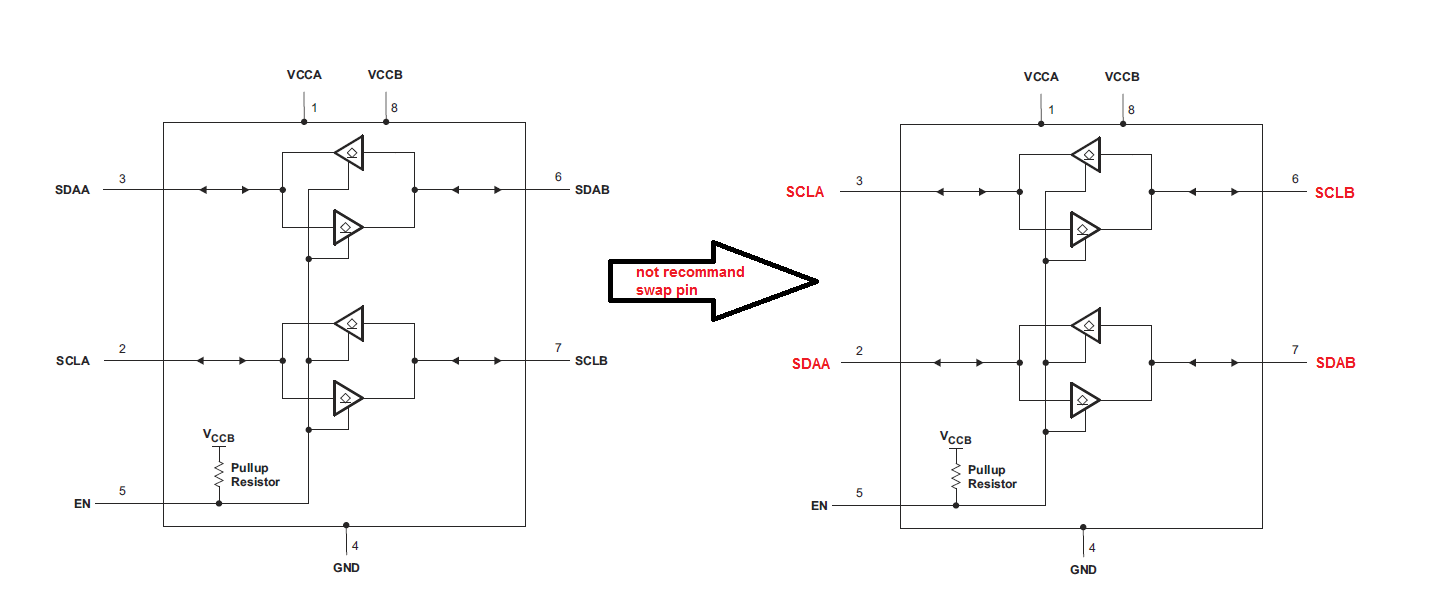

Let me confirm the usage of "EN(5pin)" of TCA9517.
I think EN pin is pulled up to VccB device internally.
That is to say, when we always use TCA9517 as active, we can leave EN pin open, correct?
Of course, it is also no problem to pull-up EN by external resisiter.
Will you tell me your advice?
