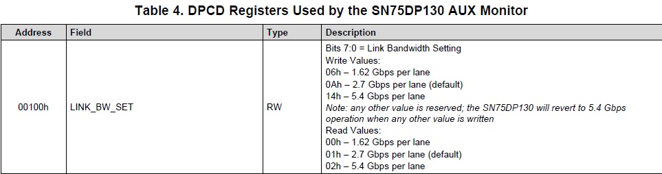

Dear Sir
If I use 4k/2k on SN75DP130 ,should I modify below register from 2.7Gbps to 5.4Gbps ??
