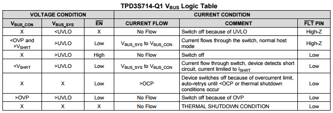

    The behavior you're experiencing is intended operation of the device.  When the TPD3S714 is powered on and above UVLO, but disabled, the device asserts FLT.  See below logic table from the TPD3S714 datasheet:

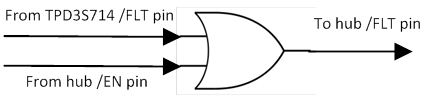

    If this is causing the hub to disable, my recommendation would be to add a simple OR gate to the FLT pin tied into the hub EN pin.  Here’s a quick example schematic of how to implement this:
    Our sister group over in SLL has a great selection to choose from: http://www.ti.com/lsds/ti/logic/or-gate-products.page
    With EN + FLT tied together, the FLT will only assert back to the microprocessor when the device is both enabled and asserting a FLT.

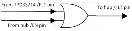

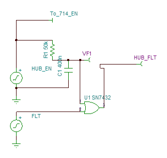

    Per our discussion on the phone, adding an RC decay circuit between hub /EN pin and the OR gate (while still connecting the EN without the decay directly to the 714) should have the correct response.  See this diagram below:

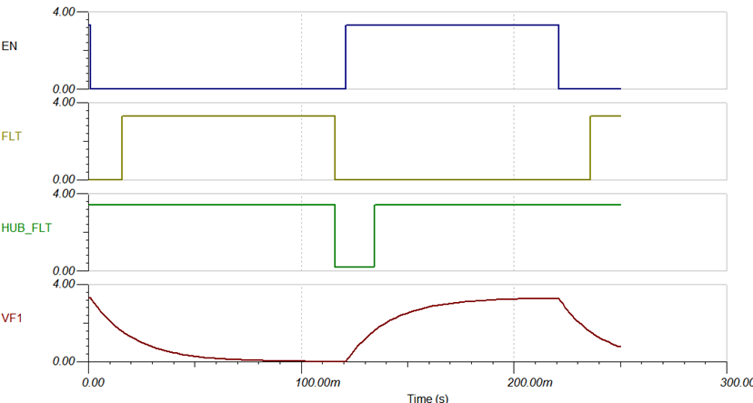

    Here's the simulation showing this should all work properly:
    This should effectively allow EN and FLT to all work properly.  You’re correct that there is a possibility of RC degradation, but if you set the value properly and high enough I don’t see that causing an issue.
    As mentioned, the TPD3S716 should obviously solve the problem altogether without using any extra passives.  Another alternate would be a delay circuit, but that may be a more expensive overall solution.
    A final alternative just leaving the TPD3S714 enabled and tied to ground.  Besides port management/power conservation, there’s not really a need to disable and enable the device.  It should be able to recover out of all faults by itself without intervention of the user (assuming the fault is removed).  Leaving the enable low would allow time for the fault to disable on powerup and should function without an issue.
