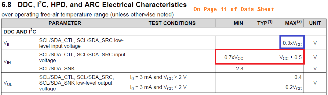

The VIL and VIH parameter for SCL_SRC and SDA_SRC is mentioned on page 7 and page 11 of the data sheet.
However, these references are different. as below.
Could you please tell us which is correct ?
Page 7 :
         VIH = 1.8V ~ 5.5V
         VIL = -0.3V ~ 0.3 x VCC
Page 11 :
         VIH = 0.7 x VCC ~ VCC + 0.5V
         VIL = 0.3 x VCC(Max)
