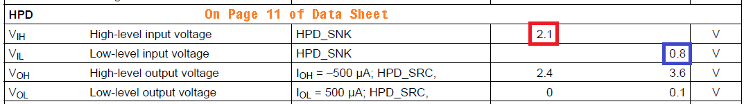

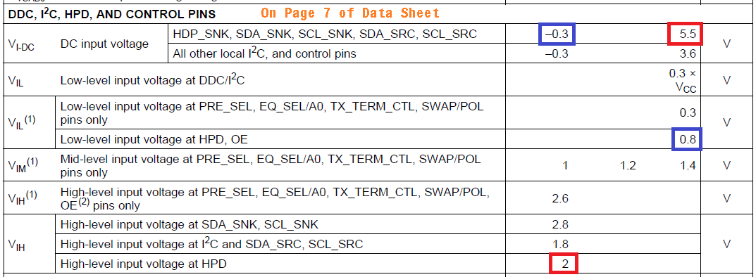

TMDS181 VIL and VIH Parameter for HPD_SNK
The VIL and VIH parameter for HPD_SNK is mentioned on page 7 and page 11 of the data sheet.
However, these references are different. as below.
Could you please tell us which is correct ?
Page 7 :
         VIH = 2V ~ 5.5V
         VIL = -0.3V ~ 0.8V
Page 11 :
         VIH = 2.1V(Min)
         VIL = 0.8V(Max)
