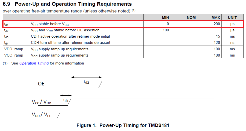

The power on sequence is mentioned on page 12 of the data sheet as below.
What kind of issue occurs if td1 is not satisfied ?
Moreover, could you please tell us the power off sequence which you recommend as well ?

Hi Kato,
Don't worry about Td1, as long as you comply with td2 everything should work fine.
In most cases Vdd powers digital circuitry, that's why it has to be asserted before Vcc.

Does TMDS181 have the esd protection diodes between VDD and VCC ?
Kato
Hi Kato,
ESD diodes are place in IO pins, one from GND to IO pins and another from IO pin to power supply.
There is no need for diodes between Vdd and Vcc.

By the way, could you please tell me the power off sequence which you recommend ?
