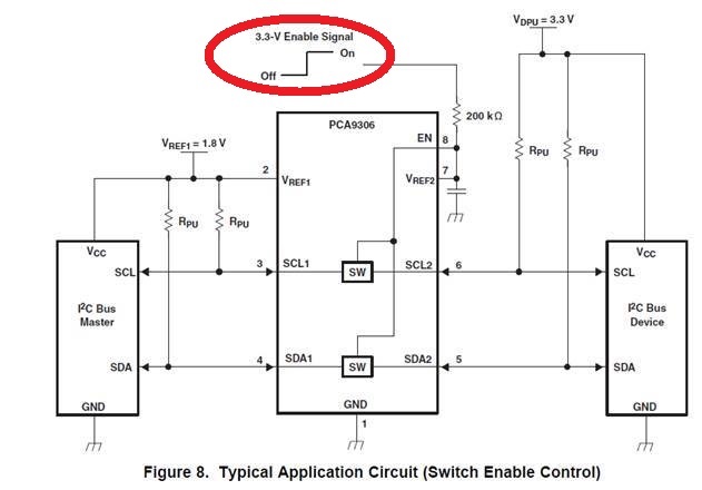

Hi team,
If we follow the Fig. 8 Typical Application Circuit.
How much is the value of driving current at EN and Vref2 pins?
Thanks.

Hello Prescott,
Due to the design of the device, the required drive current of the enable source is the following:
I = (V_EN_Source - (Vref1 + 0.7 V))/200k
So for the example values shown in the datasheet:
Vref1 = 1.8 V
V_EN_Source = 3.3 V (The voltage of the source connected to the EN/VREF2 pins, which should ideally be the same voltage as VDPU)
[3.3 V - (2.5 V)] / 200k = 4 uA
