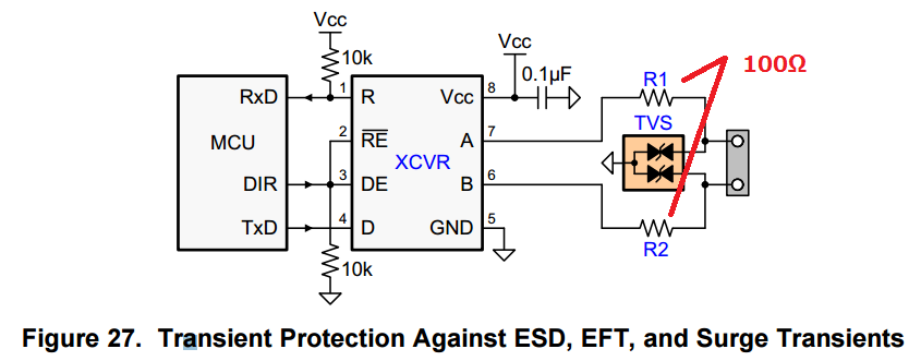

I have a question about TVS application.
www.ti.com/.../sn65hvd10.pdf
I think that the recommended value of this series resistance is between 10Ω and 20 Ω.
However, my customer uses 100 Ω.
Is there a possibility that cannot communicate normally?

    Yes, 100 Ohms is too large of a series resistance. Since the RS-485 bus should have 120-Ohm termination at both endpoints, the effective bus loading will be 60 Ohms (120 Ohms || 120 Ohms). Having 100 Ohms in series on both lines would cause the transmitted signal to be attenuated by a factor of about 77%. Resistances in the 5 Ohm to 10 Ohm range would be more appropriate.

  • Hello Max,
    Thank you for your prompt reply.
    Understood.
    I'll tell my customer to change the resistance value.
    Thank you very much.
