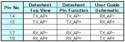

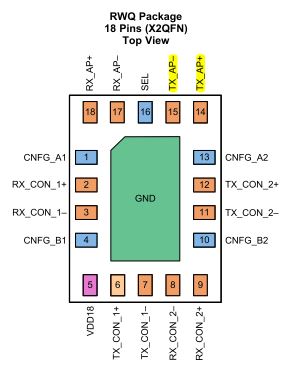

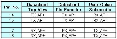

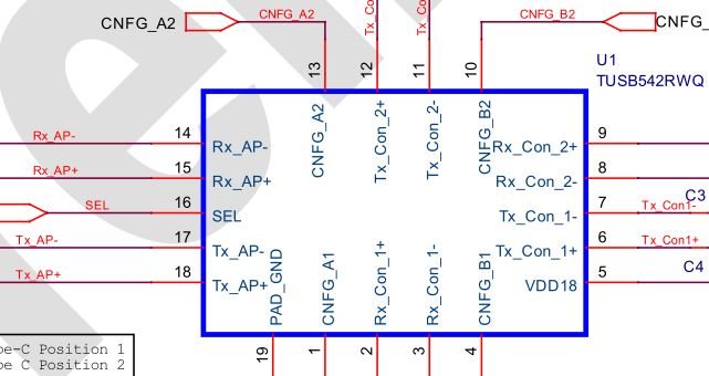

The pinout package drawing and pin function table in the data sheet differ from the board schematic in the EVM manual for the RX_AP and TX_AP differential pairs.  The layout example in the data sheet appears to match the EVM schematic.
What is the correct pinout for these four pins?
