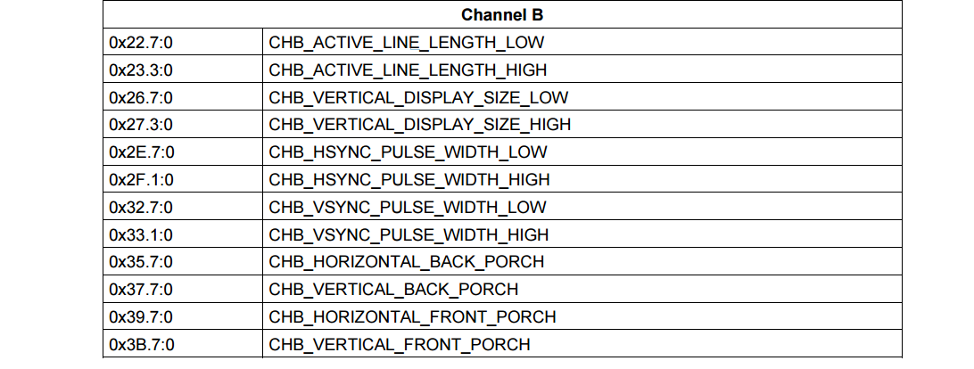

I have some questions about sn64dsi84 and I would like some help, please.
I've started working on a Jetson-TK1 platform that has two sn64dsi84 bgas to drive two lvds 1920x1080 monitors.
The board is ready, I've made almost everything working and now I have to bring-up the displays. I'm trying to i2c probe the chip from u-boot but it doesn't respond to any i2c commands (100KHz). I've validated the i2c commands with a scope and they are fine. The datasheet mentions that the dsi lines have to be in LP11 state to have access to the i2c registers. This means that the chip won't reply at all to any commands if the dsi output is not in LP11 state?

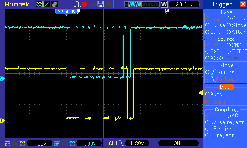

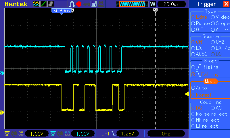

Only by following this init sequence the chip responds to i2c commands?
Also I'm bit confused about the i2c addresses. The datasheets refers that depending the address pin the addresses are 0x58/0x59 or 0x5a/0x5b for w/r. On the other hand there is an example script (8.2.2.1 in the datasheet) that uses the address 0x2d. The weird thing is that also the dsi2lvds driver on the tegra linux kernel uses that address, too. Also in the kernel driver there's no such init sequence that puts the dsi in low power mode to access the external dsi2lvds converter.
Do you provide a driver or I have to implement it by myself? It would be very convenient for developers if such driver existed, especially now that the tegras are so up-market and many manufacturers still using lvds displays.
Thank you in advance!
PS. I also have some other questions regarding the dsi tool and the parameters but first I have to bring up at least the displays.
Dimitris.
  • When ADDR=1,  the I2C addres is 0x5A (Write) and 0x5B (Read). That means that you will have to configure the 7-bit I2C slave address 0x2D. You can have access to the I2C registers anytime not only when the DSI lanes are in LP11 state.
    What is the PU on I2C SDA/SCL?

    The PU resistors are 4K7.
    What I've done in u-boot is to enable the EN pin (HIGH) and then try to send commands in address 0x2d but nothing happens. I've cross checked the VCC and GND signals for the bga on the schematics and pcb and they seem to be right, but to be honest I don't know what's going on under the bga. Then I've checked the SCL and SDA signals and they also seem ok and actually I can probe the other two devices on the bus except the DSI.
    If the EN pin is high, the address is PD and all others are NC, I should be able to have i2c communication? If that's the case then there must be something wrong with the hardware.
    Can you propose another way to check if the chip is ok?
    I'm sending you the oscilloscope screenshot of the i2c signal, just be aware that although it's displayed as 3V3 it's actually 1V8 on the dsi chip. The 3V3 are after the lever shifter which is used for other i2c devices.
    Thanks again!
    Dimitris.

  • These are the read/write in the address 0x2c. The Vcore is indeed 1.1 volts.
    I'm thinking that might be some manufacturing issue that has to do with the soldering of the BGA.
    EDIT: They seem the same because the u-boot first try to validate the address and then write...
    Read
    Write

  • Hello Dimitris ,
    It seems that the DSI Tuner tool is not generating the values of the Video Registers for Channel B. You have to fill the registers value for this channel manually.
    Joel
  • Hi Joel, I hope I had good news...
    First, you are right; the DSI tool doesn't calculate the values for LVDS CHB, only for CHA. I've edited my template structure in the kernel to driver and filled the missing values. Therefore, the I2C dump now is the following.
    # i2cset -y 1 0x0 2x   c               dump -y 1 0x2c
