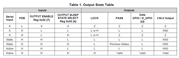

Dear Experts,
Is there any method to know whether there is one cable connect to 940 or not?
Can we use “LOCK” or ”PASS”pin for this purpose?
Thanks.
