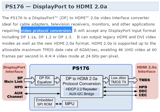

DP to HDMI is PS176 — DisplayPort to HDMI 2.0a

    You may want to ask Parade if the PS176 is a DP to HDMI bridge (aka protocol converter) or just a level translator with signal conditioning.

  • Hi Sir,
    We are double confirm with customer, this is Type-C Plug similar a dongle.
    the PS176 is protocol conversion.
    Could you please share the MDCP2850 with TI Type-C solution ref design for me?
    http://www.paradetech.com/products/displayport-format-converters/ps176/

    If there are any similarities between the PS176 and the MDCP2850, then the PS176 can probably act as a "Level Shifter/Re-timer" only or as an "Active Protocol Converter", depending on Input pin settings and the FW loaded into the device.
    I suggest that your customer speak to Parade regarding the functionality of the part.
