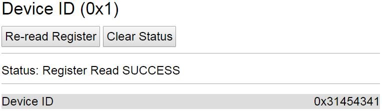

  • Hello Brian,
    Thank you so much for your strong support. Finally I was able to read the registers using the PIC MCU:
                                  Fig 1: Result on TI Utility tool
                                    FIg 2: Results obtained in PIC MCU (MPLab)
    Just in case, I have attached the results obtained. Kindly ignore [0] byte.
