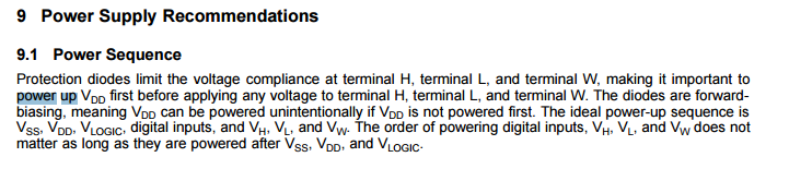

Hi Kato,
In regards to the power sequence you should follow. Please take the time to read the section in the datasheet titled "Power Sequence" at the end of the datasheet near the Layout Example. I have snipped it and posted below:
In reference to the voltages that they output please refer to a previous post:
The pins will be floating, which means that the voltage will be unknown. We can say that it will be somewhere between -0.5 V and VCC + 0.5 V

Kato - san,
The ideal power sequence would be VSS, VDD, VLOGIC, digital inputs, VH, VL, and VW.
This instance should be fine for operation.
