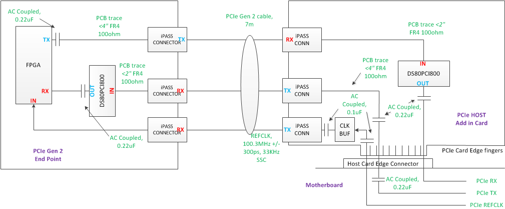

I am trying to model in webench a TX --> Cable --> DS80PCI810 --> RX.  What is confusing is how is the insertion loss number provided?  Do I have to add a -ve sign infront of the loss value?  You can see in the picture attached, this doesn't produce any good output.  But what I see in the app note is that losses of upto -40db are corrected by this part.  So I am not sure what I'm missing in my sim?
I have been told that this part can get upto 10meter on a miniSAS HD cable over Gen 3 speeds.  Looking at the miniSAS HD cable spec, I see that it has about -11dB insertion loss at 4GHz over 5m.  And the PCIe Addin card loss budget is about 13.5dB.  So 25dB doesn't seem that far fetched number.

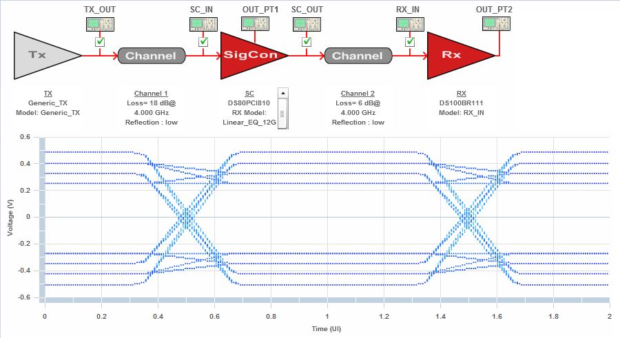

  • Hi Sanjay,
    Here is a WEBENCH setup using the DS80PCI810.  Please note that the DS80PCI810 all by itself is limited to ~ 10 dB of CTLE gain.  For PCI Express the system TX and RX will help to compensate the signal attenuation as well.
    For the PCIe Tx I am using a waveform which approximates a PCI Express P7 preset
    Generic Tx:  Slew = 40ps, Pre = -8, Pst1 = -16, Swing = 1000
    For the DS80PCI810 I am using a BST = 3 (maximum) and VOD = 4
    For the receiver I am using a DS100BR111 configured to provide a CTLE gain of ~ 6 dB at 4 GHZ.  This is the minimum specified for PCIe Gen 3 devices.
    DS100BR111: EQ_level = 1 (Range 0-15)  approximate gain = 6 dB, Limit = 0
    I have attached the simulation setup and final waveform.  To create the channels you do not need a "-" sign for attenuation.  Set frequency to 4 GHz for PCIe. Set reflection = Low.  When you click apply, the attenuation graph will plot on the right.
    The waveforms below are TX_OUT, SC_IN, and OUT_PT2

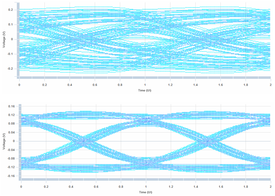

  • Sanjay,
    The total channel loss of 38 dB is a high level of attenuation.
    I can get eye diagrams, but they are not really good looking - it is at the edge of the device capability.
    I made a few changes to get a better eye opening.
    Tx - 30 dB - DS80PCI800 - 8 dB - Rx
    I changed several settings
    Tx edge rate to 40ps (more realistic)
    DS80PCI800 EQ=5, Limit=1, VOD=5, DE=2
    Rx - changed from Ideal to DS80PCI102 (to use CTLE like PCI Express)
    Rx EQ=1, Limit=0
    Lee
