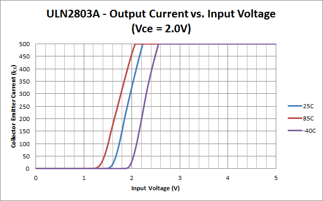

Our customers have plan to change from competitor darlington to TI darlington.
An off state threshold input voltage is unknown (min/max).
Could you provide the information me?
Nagai
Hello Nagai-san,
I do not have this information readily available, but I can test a couple samples on the bench to see what the transition point is typically.
Please allow until the end of the week for this information.
Michael
Hello Nagai-san,
Yes, this would be an appropriate way to calculate the Voff typ and range.
I will work to gather bench data on a couple units to get a typical reading.
Michael
Nagai-san,
This information is on a public forum, so this data can be shared.
Again, this is typical device data for a single unit. There will be additional variation across temperature and process.
Michael
