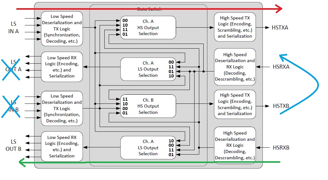

Hi.
Can TLK10232 transmit packets from LS (XAUI) to HS side ( 10G SFP+)
if HS Receive is not connected?
According to registers XAUI is aligned and no errors

  • Hi, Luis.
    I suppose you right, but I connected RX channel A and TX channel B.
    Made a XAUI loop in FPGA.
    I see receiving packets but no transmit on sfp.
    Is any workaround? It looks like TX doesn't work without Link ON on RX.
    I've made changes on working card with regular RX/TX pair connections.
    Yuli

  • Hi, Luis.
    Not actually loopback. I'm transmitting via channel A and receiving on ch B at the same chip.
    I'm using internal switch to make "loopback"
    Write 0x3300 to register 0x17 of ch A.
    I also have errors on HS receive. SFP+ is placed pretty close (1") to TI chip.
    Can it cause the problem?

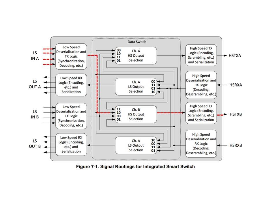

  • Hi Yuli,
    If you want to use the internal data switch feature:
    Wirte 0x3800 to register 0x1E.0017 to select alternate channel LS input (Channel B). Doing this, the input will come from LS (Channel A) and will switch to HS (Channel B). Dataflow is as follows:
    Luis
  • Hi, Luis.
    I'm working like this:
    Rest of interfaces are unconnected
    I see receive on LS side ch B (green), but no transmit on HS ch. A (red)
    Yuli
  • Yuli,
    Please write 0x2000 to 0x1E.0017 to set the device in normal operation (without data-switch). Then connect with a cable the HSTXA to HSRXB. Doing this, you should see data on HSTXA & HSRXB.

  • Hi, Luis.
    I've connected RxA to TxB like on picture.
    and made register setup below:

  • Hi, Luis.
    I 've made some experiment with other design and bring it to the same configuration as new one.
    I've unconnected unnecessary XAUI and HS side.
    Fortunately it is working.
    I'm confused. And cannot understand what is the difference between two designs except of
    different layout. I logged dump of all PHY registers.

  • Hi, Luis.
    Thanks for your help.
    I found the problem - XAUI was connected wrong.
    Anyway, the lane alignment bit show correct alignment.
    This was confused me.
