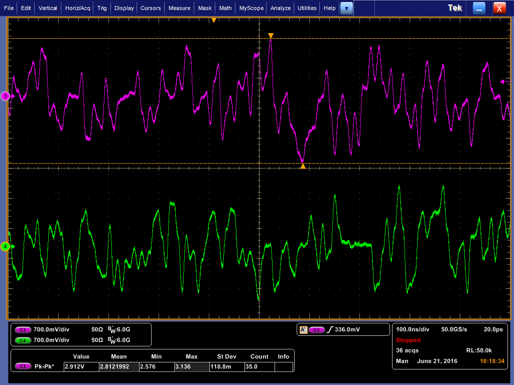

We are using the DP83865 in a new design and 10% or the prototypes can not establish a link at 1 Gbps. Some of them that can establish a link experience CRC errors. We need your help in debugging the problem. We have followed the trouble shooting guidelines and have found no apparent issues. Sometimes when we put a 100 Ohm across the differential signals the problem sometimes goes away. We have attached a scopeshot of the signal during auto negotiation as well as normal data traffic for your review.
What would cause the auto negotiate signals at the connector to be high? For example the auto-negotiation pulse is above the 2V that is shown in the troubleshooting guide.  We have followed the suggested circuit and used the magnetics called out from the datasheet.  What might cause the signal to be higher than 2V?

  • Tim,
    I think the best starting point would be a review of the schematic.  I will send you an email to make arrangements for getting the schematic.  I will leave the E2E post open for now.  If there are any learnings that we can post without compromising the intellectual property of the design, we can back annotate those after everything has been resolved.
    Patrick
  • Posting updates based on email discussions of this topic. The customer determined that the 2.5V regulator was not able to provide the required currents. They changed to a regulator that can supply more current and are successfully establishing a link now on boards there were not previously.
