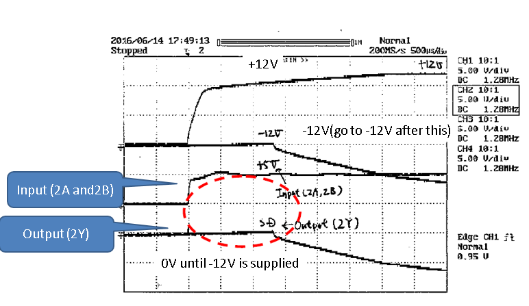

My customer is using SN75C188 as below picture.
He has a issue of unintention output at startup power supply.
This output wave is red circle at below picture.
I think that SN75C188 should output 0 voltage level until starting -12 supply.
(2A=High, 2B=High -> 2Y=Low)
Could you tell me about mechanism at this situation, please?
Shimizu
  • Shimizu-san,
    Bipolar RS232 drivers expect VCC- to be the most negative voltage on the device. Does VCC- go positive at all? Even +500mV would be too much.
    Even if VCC- stays at zero, the output may still go high. Some negative voltage may be needed to bias the internal circuits.

    Please see the below picture.
    This waveform is DS14C88M.
    The circuite is same as SN75C188M.
    It doesn't go to High logic level at not supplying -12V.
    Why doesn't DS14C88M output high level at this situation unlike SN75C188M?
    Could you tell me the difference of structure between DS14C88M and SN75C188M, please?

  • Greetings,
    DS14C88 input voltage range is from V+ +0.3 to GND -0.3. On the other hand SN75C188 input voltage range is a function of the negative supply(from VCC- +2 to VCC+).
    DS14C88 minimum input high voltage is 2.0V(relative to GND). Therefore when both inputs are 5V the output will be at 0V(independent of the negative supply).
    Regards,,nasser
