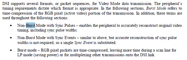

    Is the customer using burst or non-burst video mode?
    In non burst mode, the DSI CLK = minimum DSI CLK frequency required to sample in the line worth of data.
    The DSI CLK is faster in burst mode. If this the their case then the 432Mhz will be correct.
    Whether the CPU provides the data in non burst or burst mode, the device configuration does not change other than the CLK related settings.
    The burst mode only means data is provided in burst manner then the rest of the line period can be filled in LP11 which is the low power state in the DPHY definition.  During the low power state, the HS Tranceiver/receiver can be disabled to save power.
    Here’s an excerpt from the DSI spec:

    Yes, the customer uses the SN65DSI84 in burst mode.
    Then I understood the 432MHz is correct.
