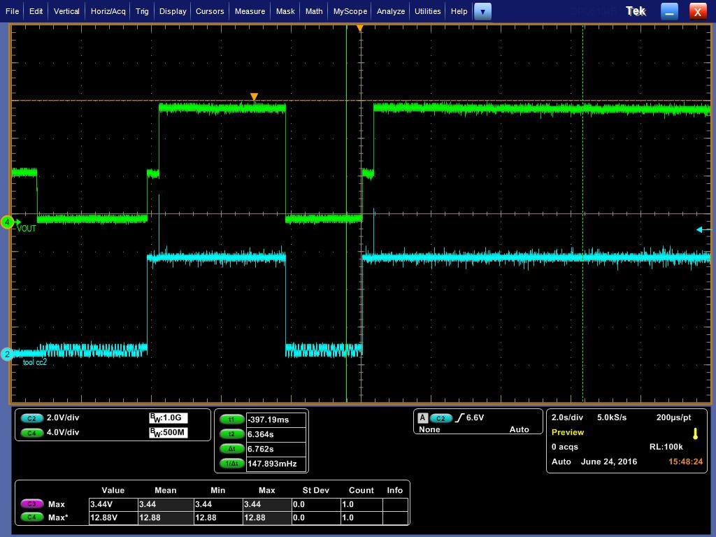

     My customer use TPS65982 and HD3SS460 in their TVSET .When connected with Macbook with type-c wire,   TVSET will charge the Macbook and will display
the Macbook's  pannel content .  Now  we find one issue as belows:

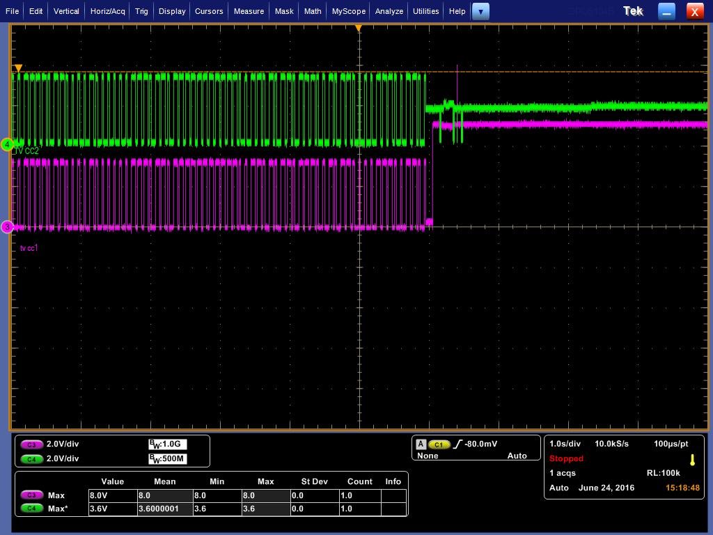

After plug and unplug Type-c wire about 30 times ,  there will be a voltage spike on CC1 Or CC2  up to 8.4V . This spike will destroy the CC pin of the TPS65982.
The Type-c  wire need VCONN powered .
The test wave of CC1 and  CC2  is as belows, you can see the spike on CC1. and the spike happened when Vbus from 5V to 12V.
Can any one help me on this issue?
Thanks very much.
  • Can you please provide the Manufacturer and Part # of the Type-C cable you are testing with?
    Which MacBook are you testing with, the 2015 model or the 2016 model? They look very similar.
    We have concerns that the pins on some Type-C cables will be unreliable and bend very easily with rapid plugging/un-plugging. Cables should be robust enough to prevent the high voltage pins (VBUS)  from contacting the lower voltage pins (CC1/2 and SBU1/2), but we cannot guarantee the robustness of cables. This is why it will help to know the cable brand and part # you are using.

         We test four kinds  of type-c wires. And we found if there is no Vconn provided  , there is  no voltage spike ,even the VBUS changed from 5V to 12V.
       No.1          Macbook type-c                                                                                                  No Vconn needed     No voltage spike
       No.2           60mm sample type-c wire (provided by customer's vendor)                    No Vconn needed     No voltage spike
       No.3           Brand:  UGREEN     Model:  US161 (usb3.1)     length:1.5 meters           Vconn needed           found Voltage spike
       You can find the wire on this: www.lulian.cn/product-482-cn.html
       Sorry for  no English version.
        No.4           100mm sample type-c wire (provided by customer's vendor)                    Vconn needed           found Voltage spike
