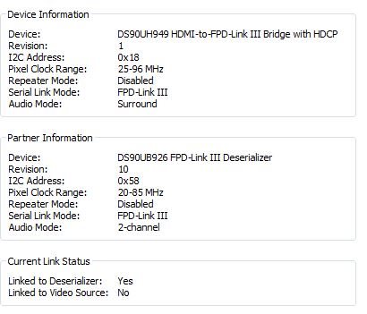

I am using a DS90UH949 EVM with a DS90UB926 derserilzer to remote a touch controller. The LVDS connection has been established correctly, you can see this from screenshot.
