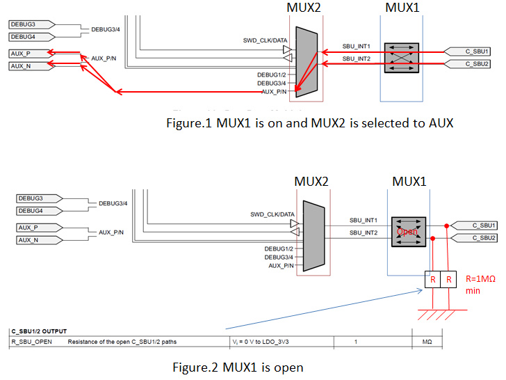

Our customer is asking about the connection for Display port (Alternative mode).
In case of DP Alt Mode, C_SBU1/2 is connected to AUX_P/N. We have questions about switching behavior.
Q1. After 'DP configure' has been done, MUX1 and MUX2 is switched to C_SBU1/2 and AUX_P/N. Is this correct ? (See below figure)
Q2. Before DP configure has been done, MUX1 is open and 1MΩ min resistor is appeared on the C_SBU1/2 line. Is this correct ? (See below figure)
Thanks in advance!
