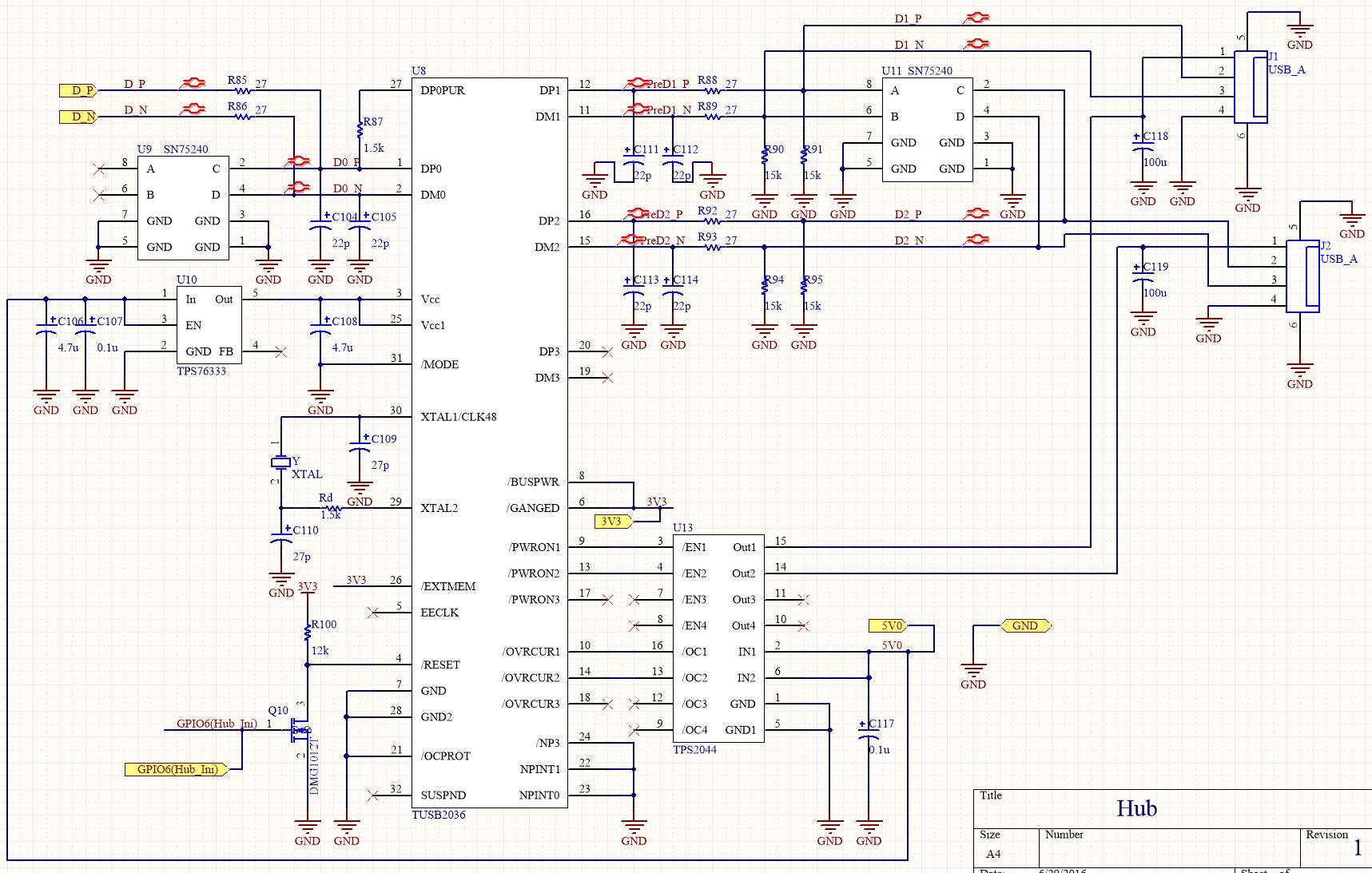

Hi All,
I have a TUSB2036 Hub circuit, basically the requirements are:
1): 2 downstream ports need to work (prefer DP1/DM1 & DP2,/DM2),
2): For individual or gang mode, either is OK.
I have following measurement:
1): TUSB2036 Overcurrent protection pins (Pin 10, 14, 18) are always low.
2): TUSB2036 Pin 6 (Ganged or individual selection pin) tied to 3.3V
3): TUSB2036 Pin 26 (External EEPROM selection pin) tied to 3.3V
4): Downstream 3 are floating (TUSB2036 Pin 19, 20 are floating)
5): Power -on/-off control signal and overcurrent protection signal for downstream 3 are floating (TUSB2036 Pin 17, 18 are floating)
Now the problem is:
1): Power-on/-off pin are always high. (TUSB2036 Pin 9, 13, 17), no 5V power output for 2 USB connectors
I attach the schematic below, does any one can help me to verify the correctness of the schematic?
Thank you very much!
Sincerely
Josiah
  • Hello Yanzhi,
    The DP and DM signals of the unused port should be tied to ground with 15K resistors like the pull-downs used on the active ports.
    The OVRCUR/ input of the unused port can be left tied to the other OVRCUR/ inputs if the hub is configured as GANGED.
    If the hub is not configured as GANGED, OVRCUR/ input of the unused port should have a pull-up resistor. A value of 1.5K is sufficient.
    I would like to see a scope captures of the power-up sequence for RESET#, XTAL and Vcc for the device.
