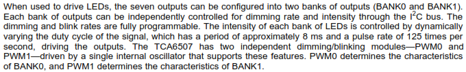

1) What does it mean that the seven output can be configured into two banks of outputs (BANK0 and BANK1)?
2) How is PWM0 related to BANK0? And PWM1 to BANK1.

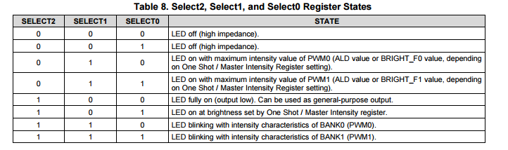

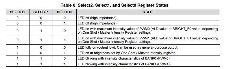

    Let me first start by explaining the SELECT registers. In the TCA6507, you have the option of writing to 3 registers (SELECT0, SELECT1, and SELECT2). Each bit of these three registers corresponds to a specific Port on the device which controls a specific LED. Please refer to the attached table to see how configurations of bits within the 3 registers change what the LED will do. For example, bit 0 will correspond to P0 and what those bits are set to will set the LED in a certain state.
    Now in regards to BANK0 and BANK1, think of them as assignments for which LED will be placed into. For example, LEDs P0 - P4 can be "Controlled" by BANK0 and the rest in BANK1. It is merely a control BANK to have various blinking.
    2) How is PWM0 related to BANK0? and PWM1 to BANK1?
    This will apply to both BANK0 and BANK1.
    PMW0 relates to BANK0 in regards with the PWM0 controlling the light intensity of the LEDs.

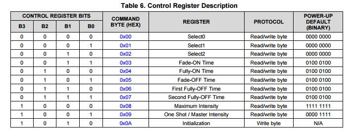

    The device, TCA6507, is an LED driver that acts off specific ports that control the LEDs. To use one of the ports, you must use the Select[0-2] to ensure that your LED is turned on.
    The intensity of each bank of LEDs can be customized by programming six registers: Fade-ON Time, Fully-ON Time, Fade-OFF Time, First Full-OFF Time, Second Fully-OFF Time, and Maximum Intensity registers.
    Please take a look at the Control Registers below to get an idea of what registers are available. Below all the control register descriptions in the datasheet are the individual registers and the descriptions of how to control the intensity of light. Also please take note of the initialization register (0x0A) which determines whether to initialize each PWM and provides a starting point of the LED intensity cycle for each bank.

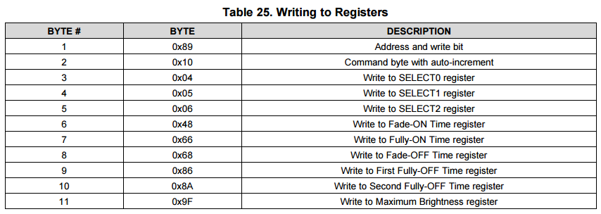

    I started to work on this already, however I run into some problems. I have a question, why was the address byte set to 0x89, when in fact, it is a write operation, for write operation (Address bits)(0--> Write), it must be 10001010-->8A.
    Also, can you provide an example table for me to start the writing process to control the intensity, which is similar to this: This is the application example from the datasheet for the blinking pattern of LEDs. Can you guide me what must be the first byte to send, and then second until the next, in order to control the intensity of the LED.

    I'll take this request over. Please refer to section 9.2 in the datasheet () as I gave a fairly detailed example about how to program a light blinking pattern.
    If you only care about changing intensity, then you just need to change the maximum intensity register only as outlined in my example in the datasheet (register 0x08).
