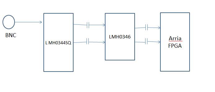

    Please find the SDI receiver block diagram below. Since the cable length will be more and there is a possibility of jitter, I have included a reclocker between FPGA and Equalizer. Please let me know whether the reclocker position ( between equalizer and fpga) is proper for eliminating jitter. Also please let me know if there is any other reclocker for SDI with better characteristics.

  • Hi Madhu,
    The positioning of the LMH0346 looks appropriate.
    Typically, the reclocker is placed in one of two locations, and it looks like your implementation uses Choice (1):
    1. After the Cable EQ device and before the FPGA or Cable Driver
    2. Before a Cable Driver device and after the FPGA or Cable EQ
    In addition to the LMH0346, you may also want to consider the LMH0366, which features lower power operation than the LMH0346 as well as an internal eye opening monitor (EOM) for debugging purposes.
    Michael

  • Hi Michael,
    In my application, the SDI camera will be far away from the board where equalizer is present. And, the FPGA will be very near to SDI driver. So I'm using reclocker only between equalizer and the FPGA.
    For the reclocker LMH0346MH/NOPB,
    1)If the second output pins are not used, how to connect SCO/SDO2, its inverse signal and SCO_EN pins?
    2) Any design guidelines ( such as decoupling, layout recommendation etc) available for this device?
    3) Whether both VCCO and VCC can be connected to single 3.3V supply?
    Madhu
  • Hi Madhu,
    1. If the secondary output is unused, I recommend that you terminate the unused SDO2 outputs (both true and complement) with two 50-ohm resistors and a center tap capacitor to GND. You can leave SCO_EN disconnected, since it has an internal pull-down.
    2. We do not have any design guidelines yet for this specific device. However, feel free to use the 100-ohm side and power supply recommendations of the LMH0303 (Section 9, 10.1) as a reference.
    3. Yes, these can be connected to the same supply. I recommend using a 0-ohm or ferrite bead option to allow you to separate the two supplies if necessary.
