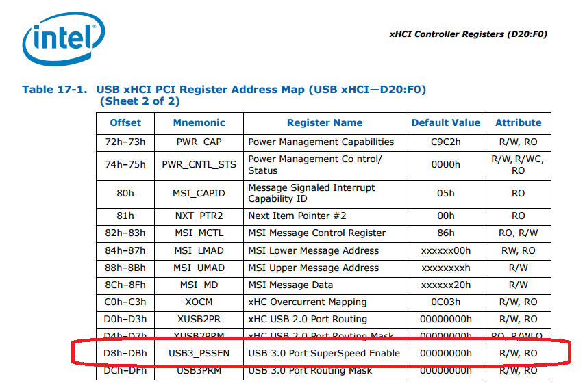

    We have a design called KiddiCraft leveraging TI TUSB7320 PCIe-USB controller, the project is nearing MP phase but just encounter a USB compatibility issue recently. The issue can be duplicated with high probability with TUSB7320 communicating with USB endpoint in xHCI/USB3.0 modeTo further diagnose the issue and work around.
    We did the experiment with Fedora Core 23 (Linux kernel 4.9) and it passed the same stress test. It says that there may be a solution from driver side. But we are using Linux kernel 3.10 and it's usb driver architecture are big different from 4.9.
    Is any method to set TUSB controller to USB2.0 mode by EEPROM register?
    We find that intel did provide this feature.
    Thanks for your reply

  • Hello Shu-Cheng,
    The issue referenced above in this post hasn't been addressed in Linux kernel version 4.9, so I do not think this is the same issue.
    The Linux community has been implementing a lot of workarounds on their USB driver stack since kernel version 3.10, hence we recommend moving to the latest kernel version available.
    Unfortunately our controller has no register setting to disable SuperSpeed capability on its ports.
    Jorge
