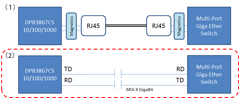

My customer is considering DP83867CS.
DP83867CS is connected to other ether phy directly on the same board.
Would it be possible for them to connect to other phy without transformer?
#It is the following (2) like "Sigle Cap Isolation Topology".
