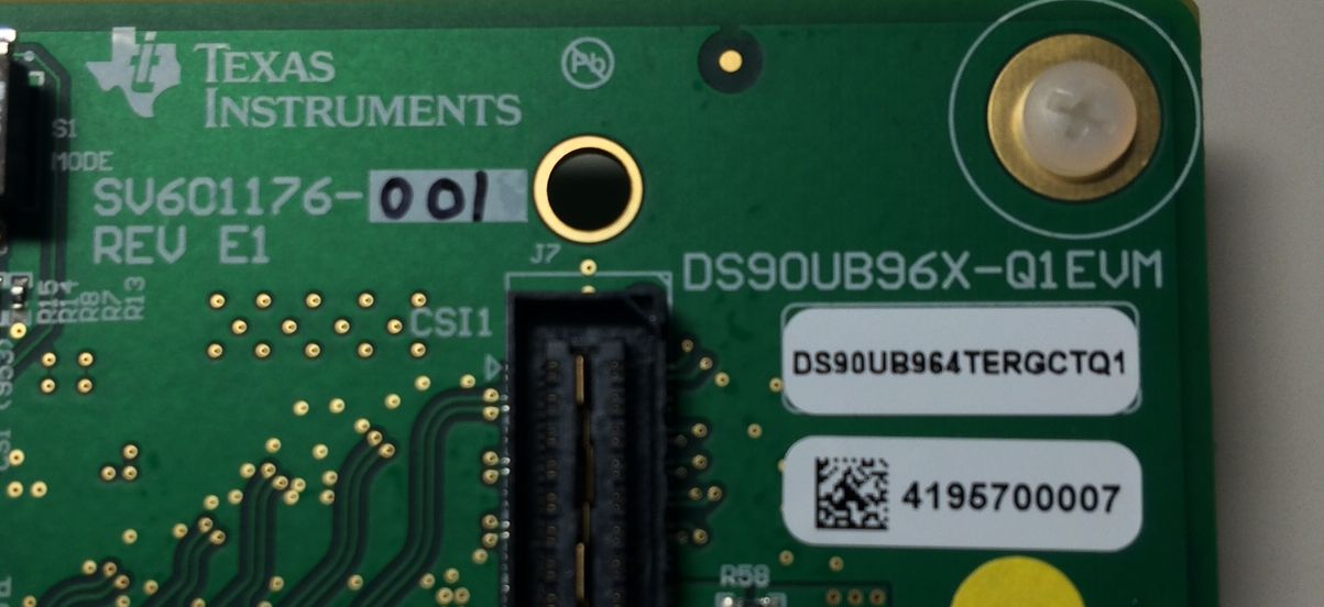

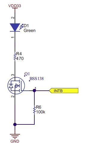

 Is LED circuit of INTB on UB960EVM correct?
 INTB pin is Open-Drain with Pull-up 4.7 kΩ to VDDIO. However, the EVM is Pulled down.
