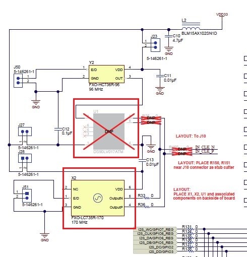

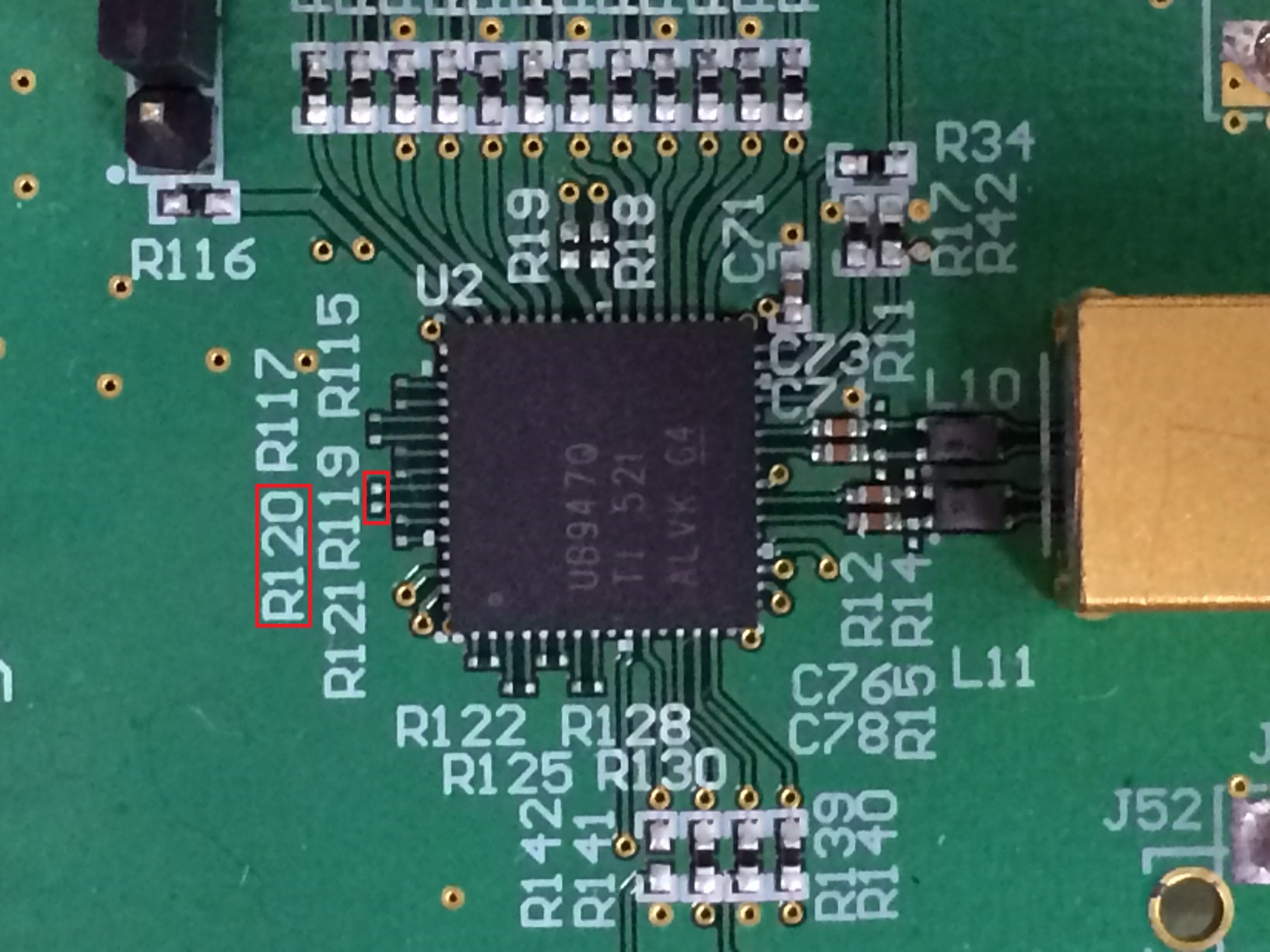

My DS90UB947 EVM was not implemented R120(IN_CLK) of termination resister.
Termination resister of other data lines was implemented.
which means that forgot implement it or no need to Implement it?
Please let me know the reason, if R120 does not need to implement only.
