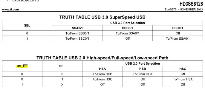

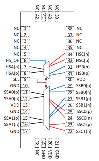

Please allow me to ask if HS_/OE pin affects SuperSpeed output or not. Customer says that it would not work as the truth table evaluating with the EVM.
I believe it would only disable High Speed Output only, regarding the truth table.
