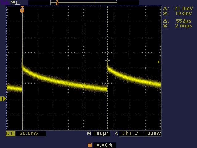

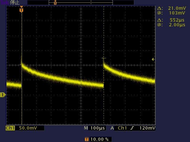

I posted following question and have an additional question.
Has the application used the TUSB211 passed USB-IF compliance program?
My customer is worrying to affect this noise to certification.
Kuramochi
Kuramochi
The TUSB211 has passed USB2.0 Electrical and CV compliance testing as part of both Host and Device system testing. The waveforms observed are a result of the device detection mechanism of the device and are only present when no device (Or terminated test fixture) is attached.
No issues have been observed with this test. What specifically is the concern?
This waveform will not be present when a device is connected. The waveform captured is only present when the TUSB211 is looking for a physical device connection.
