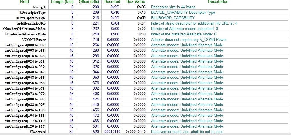

I tried the latest TSB65982 Application Customization Tool(2.8).
I selected TPS65982_HD3SS460_DRP_Source_Full_2_8.tpl and "USB3.x and DisplayPort" and "HD3SS460" are checked. "Thunderbolt" and "Alpine Ridge" are not checked.
Then TPS65982 EVM was connected to Windows 10 PC using C-toA cable to check the USB Billboard Class. However the TPS65982 EVM was not recognized, "!" mark was seen on Device Manager.
I attach a screenshot of the BOS descriptor.
bNumberOfAlternateModes is "0".
I think it should be 1.
When "USB3.x and DisplayPort" and "Thunderbolt" are checked, the TPS65982 EVM was properly recognized. bNumberOfAlternateMode is "2".
Could you check this?

  • Brian,
    The .tpl I selected worked fine as Displayport Alt mode.
    But I used a Windows 10 PC which does not have a type-c in order for the TPS65982 to be able to expose USB Billboard information.
    I want you to see the BOS descriptor which supports DisplayPort Alt Mode. The BOS descriptor is not correct, so the USB host does not send a Set_Configuration request but issues a usb reset.
    When the .tpl is configured as DisplayPort and Thunderbolt Alt Modes, the TPS65982 correctly exposes the USB Billboard information.
    Masumi Saito
