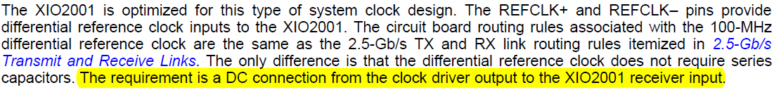

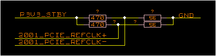

XIO2001 REF clock requires DC connection. If AC couple used, is below dc bias circuit ok for use? thanks
