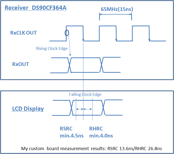

Q1. I would like to know if I understand it correctly.
RxOUT is output from DS90CF384A in synchronization with the rising edge of RxCLK OUT.
Q2. I want to use the DS90CF384A at 25MHz(40ns) of the shift clock.
Are RSRC and RHRC of f=25MHz same as a value of f=65Mz?
