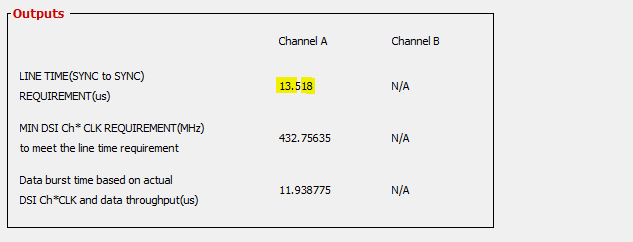

    Only the DSI85 has access to channel B video registers (sorrry for the confusion in your previous post).
    Since the DSI84 is working as single DSI Input to Dual-Link LVDS bridge it is required to program the length, in pixels (1920), of the active horizontal line in the register 0x20 and 0x21, the the HSync Pulse Width in 0x2c and 0x2d, the VSync Pulse Width in 0x30 and 0x31 and the Horizontal Back Porch in 0x34.
    The SN65DSI84 expects the GPU to provide video timing events and active pixel data (1920p) in the proper order in the form of a real-time pixel stream.
    The DSI input timing parameters MUST match the calculated value by the DSI Tuner tool(calculated based upon the DSI configuration and panel requirements). The DSI83 does not realign the timing. The line time presented in the DSI input should remain the same at the LVDS output(per the panel requirement). The mismatch of the timing may result in internal buffer underflow/overflow which typically flag the errors you are reporting(SOT and LLP error).
    For example:
