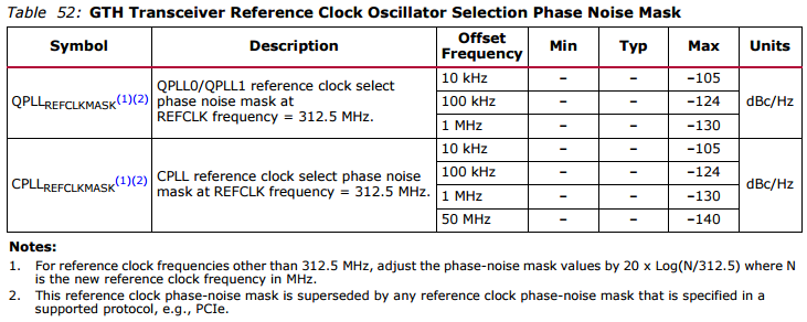

Kintex ultrascale specifications as follows.
Please refer to page 48 Table 52 of "ds892-kintex-ultrascale-data-sheet".
When it's normalized by 148.5MHz about QPLLrefclkmask, it's as follows.
10kHz offset : -114.5dBc/Hz
100kHz offset : -130.5dBc/Hz
1MHz offset : -136.5dBc/Hz

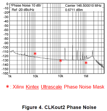

I plotted the phase noise mask in Figure 4 of LMH1983 datasheet.
[Q]
I think  the performance of LMH1983 (PLL2 & PLL3) does not meet the Kintex ultrascale FPGA specifications.
How do you think ?
My plan is as follows.
LMH1981 -> LMH1983 (only use PLL1 for Genlock Jitter cleaner) -> LMK03328 or LMK0482xB or LMK0480xB or LMK03806B (Generate Video Clock)
How do you think ?
Do you have any good ideas for this matter ?
