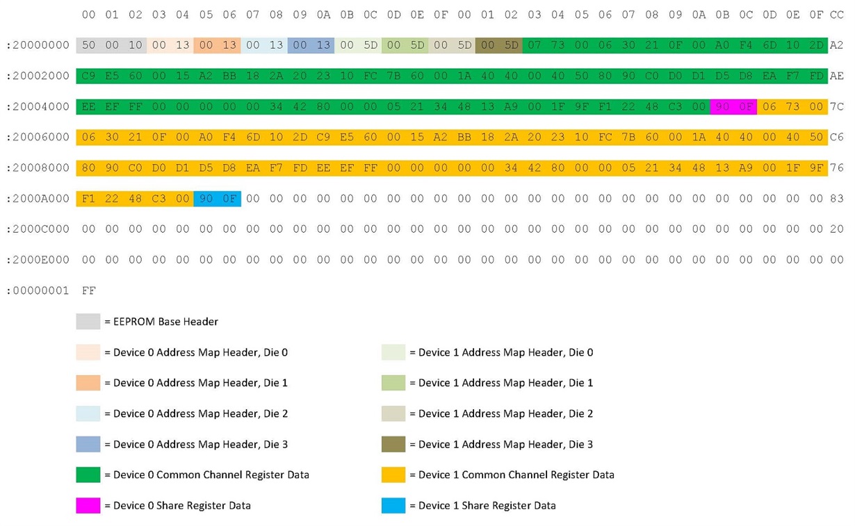

  • Hi Michael,
    Thanks for your help.
    I've made a map for 2 Devices (DS250DF410), CRC disabled
    - Enable Address Map Header
    - Enable Common Channel Configuration
    - Set EEPROM =< 256 Bytes
    - Device Count = 2
    Would you please take a look at it?
    Anything wrong please let me know.
  • Hi Justin,
    The EEPROM looks clean to me. The only comment I would add is that in the very first byte, you specify the Device Count by setting the lower nybble to be "1," so the first byte should be 0x51. The device count is one less than the number of devices connected. While the device count ultimately makes no difference when it comes to how the DS250DF410 loads the EEPROM, it's just helpful as a reference.
    Also, please note that in order for your devices to work with this EEPROM .hex file, Device 0 must be configured with address 0x30 (or 7-bit address 0x18), and Device 1 must be configured with address 0x32 (or 7-bit address 0x19).
