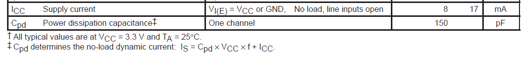

Can anyone please tell me maximum power requirements of RS422 receiver AM26LV32I.
In its datasheet it is written as
-Ultra-Low Power Dissipation . . . 27 mW Typ
-235 mW With Four Receivers at 32 MHz
I am a bit confused about these statements.

  • Azeem,
    For maximum power needed, start with data sheet table for ICC static.
    17mA is maximum. Multiplied by 3.3V (VCC) gives 56mW
    Capacitance use power when switching.
    There is even a formula (that also adds ICC)
    Cpd is per channel that is toggling. f = bit rate / 2 (worst case)
