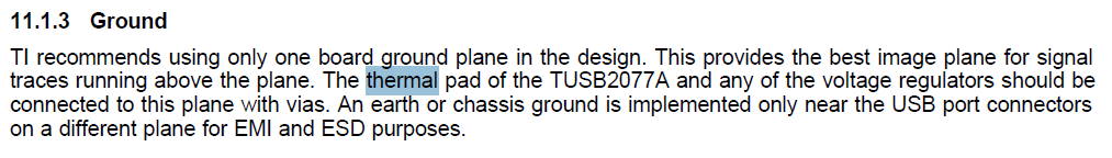

Does the TUSB2077A have a thermal pad that needs to be planned for during layout?  The Package drawing doesn't look like it http://www.ti.com/lit/ml/mtqf003a/mtqf003a.pdf but from the datasheet on page 18 section 11.1.3 http://www.ti.com/lit/ds/symlink/tusb2077a.pdf it references a thermal pad.
If there is a thermal pad, what are it's dimensions?
