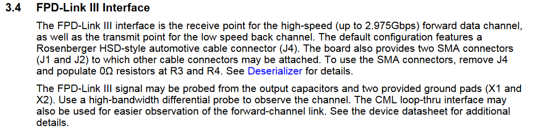

  • Mark,
    Will do. Right now after reading the EVM User Guide for the '928 I noticed the note attached to this post. I have added the 0 Ohm resistors to R3 and R4 but it still did not link. Would the HSD connector (J4) be causing the problem? Since it is not connected to anything I figured it wouldn't cause any problems. Before removing it I will check to make sure the cables are good and transmitting from both devices.
    - Chris
