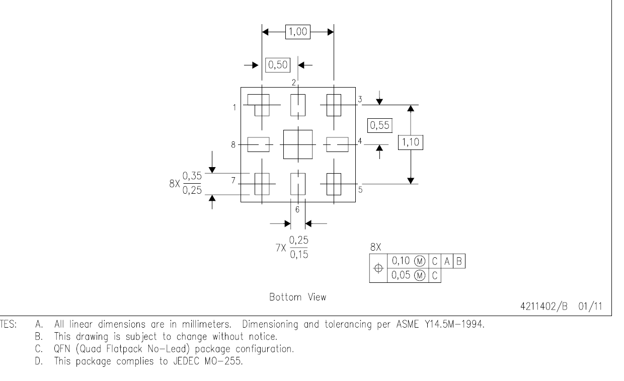

Our customer use the TCA9509, with QFN package.
The customer will solder the pad to GND.
Could you give me the recommended land pattern for soldering?
