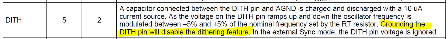

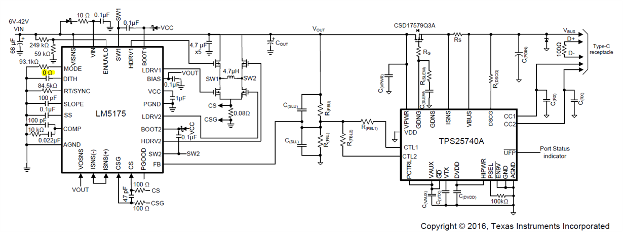

On page 47 of the TPS25740 Datasheet, in Figure 56, the capacitor next to the DITH output of the LM5175 has a value of 0 Ohms. The component is highlighted in the picture below.
What is the value of that capacitor suppose to be, or should it just be shorted to ground in this case?
