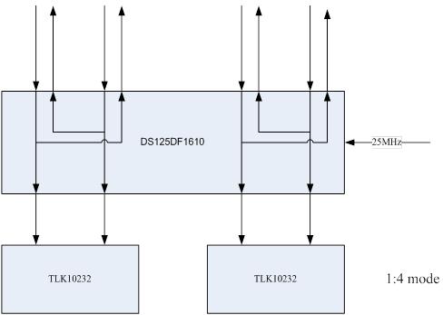

Hola,
1. I will use DS125DF1610 with 4 TLK10232 for data re-time、re-gen、re-shape.
2. DS125DF1610 4 block each block will do as below, data will multi-cast to 2 port.
3. TLK10232 will use 1:4 mode and doing 8B/10B monitor only, does it need refclk?
4. Does DS125DF1610 per port can setup different speed?(2.4576G、3.072G、4.9512G、9.8304G)
5. Does TLK10232 monitor only need provide refclk?
